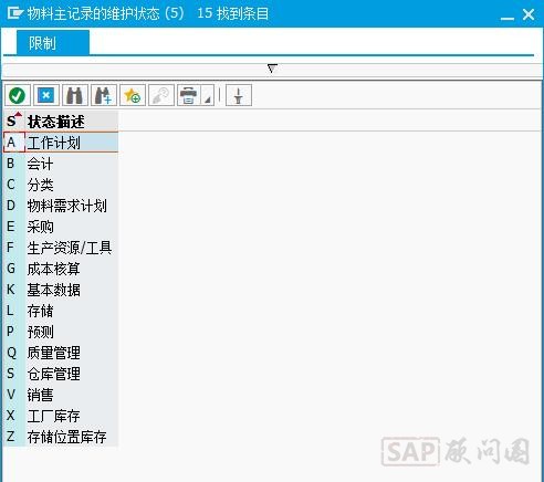

场景:需要查询启用采购视图的物料,参与采购流程
物料视图有15种维护状态,可用使用MM50扩充物料视图查看
这些维护状态拼成字符串存储在MARA-PSTAT/PSTAT中,表示物料启用了哪些视图,具体如下:
  • MARA-VPSTA- tells you all the views that have been created for the material. and Plant Stock and Storage Location stock views get created automatically.
  • MARA-PSTAT - tells you the views that have been created manually.
  • MARC-PSTAT - tells you the view created manually, relevant to Plant
  • MARD-PSTAT - tells you the view created manually, relevant to Storage Location data (Storage)
  • MBEW-PSTAT - tells you the view created manually, relevant to Finance (Accounting and Costing)
程序判断方法:
  1. marc-pstat CA 'E'    "启用了采购视图的物料
  2. marc-pstat CA 'EV'   "启用了采购视图或销售视图的物料
