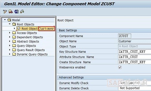

7、创建Root Objects:Customer
输入Key Structure Name , Attribute structure name and Create structure name
调整BOL对表字段的属性状态:可编辑
