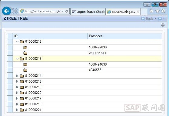

In WEB UI terminology, there is no special view type for tree view as we have form view and table view. We can consider tree view is a special form of table view. There is no wizard available to create a tree view. We need to adapt existing view into table view by following certain manual steps.
At first, it looks difficult, but the more number of times you do it, the more you understand it. In this chapter, I am going to create a tree view that looks like below.
As you see, it has two levels. First level will show the lead ID and next level will show its customer. I took this example for simplicity.
In order to follow this tutorial, we need to create one table view. I am not going to describe steps to create a table view as we had already covered it in the previous lessons. In this chapter,
I created one table view with base entity ‘BTQRLeadDoc’.

What I did?
I simply fetched first 10 lead records and feeding the context node LEAD with those records. As I did data binding between table view and context node of component controller, data will flow to the table view as well.

Next create two event handlers with name collapse and expand in the view implementation class and write the following code.

As name suggests, these are triggered when you expand or collapse any node.
Last thing is we need to add little bit coding in the DO PREPARE OUTPUT method to call REFRESH method.
  1. METHOD do_prepare_output.
  2.   IF me->typed_context->lead->node_tab IS INITIAL.
  3.     me->typed_context->lead->refresh( ).
  4.   ENDIF.
  5.   CALL METHOD super->do_prepare_output
  6.     EXPORTING
  7.       iv_first_time = abap_false.
  8. ENDMETHOD.
Now you can execute the application and see the output.  When we learn it first time, it seems too many steps, but in actually, it is not that much difficult.
Here if I want to display ‘address’ as child to ‘customer’, Then I need to create one more proxy class and write the code in the GET CHILDREN method of CUSTOMER proxy class by using BOL relations from customer to address and need to add one GETTER method to that proxy class to display the address. Don’t forget add one more column ‘address’ in the GET_TABLE_LINE_SAMPLE.
You can try it on your own. Hope it helps you and do refer this site to your colleagues if you think it deserves it.
