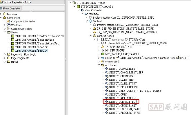

Go to the UI component and result view context node.
In order make any field as a hyperlink we need to code in its P GETTER method. P stands for Property. This method is used to change the property of a field. Right click on it and choose generate P getter method. Frame work will generate p getter method . Green symbol indicates that.
Double click on the method and put the following code inside the method and activate it. Here 'objectid' is an event name that will be triggered when user clicks on that hyperlink.
