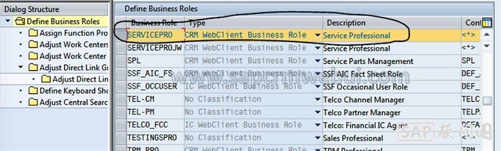

See the business role with which you logged in and go to the transaction code CRMC_UI_PROFILE or use the below SPRO path.
Path in SPRO -> Customer Relationship Management->UI Framework-> Business Roles-> Define Business Role.
Here I am choosing the service professional role.
go to the transaction and look for the above mentioned role in the SAP GUI. After finding the role just double click on it.

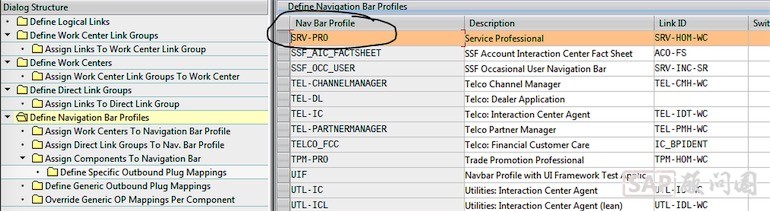

We can see the value for the field navigation bar profile SRV-PRO. This is the navigation bar profile associated with the business role. First step is completed.
Then execute the transaction CRMC_UI_NBLINKS to see the entries in the navigation bar profile SRV-PRO.

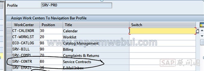

Let us see the work centers assigned to this navigation bar profile. Select the profile and click on Assign Work Centers To Navigation Bar Profile. You can see the work centers associated to the profile. You can also see the work centers and their positions and title of the work center. If we observe the position of the HOME work center, we can notice that its position is 10 and 10 is the least among all other positions that’s why it appear at top of the navigation bar on the WEB UI.

We are on the work center page.  So what is the work center on which we clicked to navigate to this page?
We have clicked on SERVICE CONTRACTS work center on navigation bar. So we need to look at the all work centers assigned to navigation bar profile.
Yes, we found the service contracts work center SRV-CONTR.
