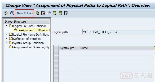

2、设置idoc归档需要的 Logical path and Physical path
T-code FILE,新建New Entries
Logical file path definition逻辑文件路径定义: New entries ——> Logical file path中填入逻辑路径名
选中双击,Assignment of physical paths to logical path为逻辑路径指定物理路径
/data_archiving/<FILENAME> (Syntax group UNIX)
\data_archiving\<FILENAME> (Syntax group WINDOWS NT)
必须以<FILENAME>结束
