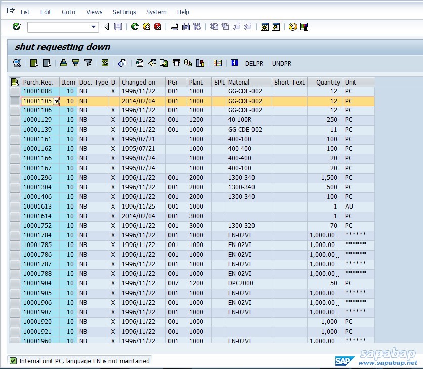

在业务中存在采购申请因某些原因需要关闭的情况,但用户打开采购订单进行删除时比较麻烦,如何进行操作?可将采购申请进行列表显示,让用户进行选择关闭,显示处理结果。

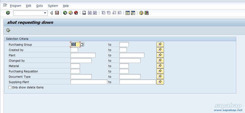

选择屏幕

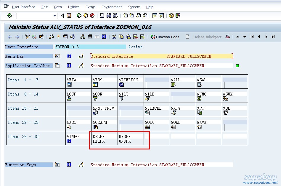

自定义delpr和undpr两个按钮实现采购申请的关闭与打开

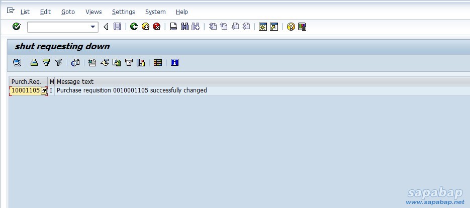

消息提示

  30. SELECTION-SCREEN BEGIN OF BLOCK BLK_001 WITH FRAME TITLE TEXT-001.
  31. SELECT-OPTIONS:S_BSART FOR EBAN-BSART,
  32.                S_EKGRP FOR EBAN-EKGRP,
  33.                S_ERNAM FOR EBAN-ERNAM,
  34.                S_ERDAT FOR EBAN-ERDAT,
  35.                S_WERKS FOR EBAN-WERKS,
  36.                S_RESWK FOR EBAN-RESWK,
  37.                S_BANFN FOR EBAN-BANFN,
  38.                S_MATNR FOR EBAN-MATNR.
  39. PARAMETERS:P_OLDEL TYPE FLAG.
  40. SELECTION-SCREEN END OF BLOCK BLK_001.

  173. *&---------------------------------------------------------------------*
  174. *&      Form  CALLBACK_PF_STATUS
  175. *&---------------------------------------------------------------------*
  176. *       text
  177. *----------------------------------------------------------------------*
  178. *      -->RT_EXTAB   text
  179. *----------------------------------------------------------------------*
  180. FORM CALLBACK_PF_STATUS USING RT_EXTAB TYPE SLIS_T_EXTAB.
  181.   SET PF-STATUS 'ALV_STATUS' EXCLUDING RT_EXTAB.
  182. ENDFORM.                    "CALLBACK_PF_STATUS

  187. *----------------------------------------------------------------------*
  188. *      -->P_UCOMM    text
  189. *      -->PS_SELFIED text
  190. *----------------------------------------------------------------------*
  191. FORM  CALLBACK_USER_COMMAND USING P_UCOMM LIKE SY-UCOMM
  192.                               PS_SELFIED TYPE SLIS_SELFIELD.

  256.   REFRESH IT_LOG.
  257.   LOOP AT IT_DATA INTO WA_DATA WHERE SFLAG = 'X'
  258.                                AND LOEKZ <> P_DELFG.
  259.     "LOEKZ Deletion Indicator in Purchasing Document
  260.     "P_DELFG 放开关闭的采购申请字段
  261.     APPEND WA_DATA TO IT_DATA_SEL.
  262.   ENDLOOP.
  263.   IF IT_DATA_SEL[] IS INITIAL.
  264.        MESSAGE '没有选中数据' TYPE 'E'.
  265.   ENDIF.
  266.   SORT IT_DATA_SEL BY BANFN BNFPO.
  267.   LOOP AT IT_DATA_SEL.
  268.     CLEAR IT_ITEM. "Transfer Structure: Delete/Close Requisition
  269.     IT_ITEM-PREQ_ITEM = IT_DATA_SEL-BNFPO.
  270.     "Item Number of Purchase Requisition
  271.     IT_ITEM-DELETE_IND = P_DELFG.
  272.     "Deletion Indicator in Purchasing Document
  273.     APPEND IT_ITEM.
  274.     AT END OF BANFN.
  275.       REFRESH:IT_RETURN.
  276.       CLEAR:LV_ERROR.
  277.       CALL FUNCTION 'BAPI_REQUISITION_DELETE'
  278.         EXPORTING
  279.           NUMBER                      = IT_DATA_SEL-BANFN
  280.         TABLES
  281.           REQUISITION_ITEMS_TO_DELETE = IT_ITEM
  282.           RETURN                      = IT_RETURN.
  283.       CALL FUNCTION 'BAPI_TRANSACTION_COMMIT'
  284.        EXPORTING
  285.          WAIT          = 'X'
  286. *     IMPORTING
  287. *       RETURN        =
  288.                 .
  289.       LOOP AT IT_RETURN.
  290.         CLEAR IT_LOG.
  291.         IT_LOG-BANFN = IT_DATA_SEL-BANFN.
  292.         IT_LOG-TYPE = IT_RETURN-TYPE.
  293.         MESSAGE ID IT_RETURN-CODE+0(2) TYPE IT_RETURN-TYPE NUMBER
  294.         IT_RETURN-CODE+2(3)
  295.               WITH IT_RETURN-MESSAGE_V1
  296.                    IT_RETURN-MESSAGE_V2
  297.                    IT_RETURN-MESSAGE_V3
  298.                    IT_RETURN-MESSAGE_V4
  299.               INTO IT_LOG-MESSAGE.
  300.         APPEND IT_LOG.
  301.         IF IT_RETURN-TYPE = 'E' OR IT_RETURN-TYPE = 'A'.
  302.           LV_ERROR = 'X'.
  303.         ENDIF.
  304.       ENDLOOP.
  305.       IF LV_ERROR = SPACE.
  306.         LOOP AT IT_ITEM.
  307.           READ TABLE IT_DATA ASSIGNING <FS_DATA>
  308.            WITH KEY BANFN = IT_DATA_SEL-BANFN
  309.                     BNFPO = IT_ITEM-PREQ_ITEM.
  310.           IF SY-SUBRC = 0.
  311.             <FS_DATA>-LOEKZ = P_DELFG.
  312.           ENDIF.
  313.         ENDLOOP.
  314.       ENDIF.
  315.       REFRESH:IT_ITEM.
  316.     ENDAT.
  317.   ENDLOOP.
  318.   CALL FUNCTION 'REUSE_ALV_FIELDCATALOG_MERGE'
  319.    EXPORTING
  320.      I_PROGRAM_NAME               = SY-REPID
  321.      I_INTERNAL_TABNAME           = 'IT_LOG'
  322.      I_INCLNAME                   = SY-REPID
  323. *   I_BYPASSING_BUFFER           =
  324. *   I_BUFFER_ACTIVE              =
  325.     CHANGING
  326.       CT_FIELDCAT                  = IT_FCAT
  327.       .
  328.   CALL FUNCTION 'REUSE_ALV_GRID_DISPLAY'

工具栏的定义,可以先copy标准工具栏,再添加两个按钮
