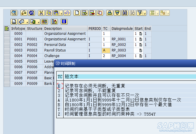

主要的参数设置:
lv_fldcat-f4availabl = 'X'.
lv_fldcat-ref_table = 'T582A'.
lv_fldcat-ref_field = 'ZEITB'.

  198.   lv_fldcat-row_pos   = '1'.
  199.   lv_fldcat-col_pos   = '6'.
  200.   lv_fldcat-fieldname = 'ZEITB'.
  201.   lv_fldcat-tabname   = 'IT_OUTPUT'.
  202.   lv_fldcat-outputlen = 5.
  203.   lv_fldcat-scrtext_m = 'Time constraint'.
  204.   lv_fldcat-edit = 'X'.

  233.   lv_fldcat-tabname   = 'IT_OUTPUT'.
  234.   lv_fldcat-outputlen = 15.
  235.   lv_fldcat-scrtext_m = 'End'.
  236.   lv_fldcat-icon = ''.
  237.   APPEND lv_fldcat TO it_fcat.
  238.   CLEAR lv_fldcat.
  239. *To create drop down for the field 'DAVO'
  240. * with our own f4 help
  241.   ty_dropdown-handle = '1'.
  242.   ty_dropdown-value = ' '.
  243.   APPEND ty_dropdown TO it_dropdown.
  244.   ty_dropdown-handle = '1'.
  245.   ty_dropdown-value = '1'.
  246.   APPEND ty_dropdown TO it_dropdown.
  247.   ty_dropdown-handle = '1'.
  248.   ty_dropdown-value = '2'.
  249.   APPEND ty_dropdown TO it_dropdown.
  250.   ty_dropdown-handle = '1'.
  251.   ty_dropdown-value = '3'.
  252.   APPEND ty_dropdown TO it_dropdown.
  253.   CALL METHOD c_alvgd->set_drop_down_table
  254.     EXPORTING
  255.       it_drop_down = it_dropdown.
  256.   LOOP AT it_fcat INTO lv_fldcat.

  277.   it_layout-zebra = 'X'.
  278. ENDFORM.                    " alv_report_layout
  279. * PAI module of the screen created. In case we use an interactive ALV or
  280. *for additional functionalities we can create OK codes
  281. *and based on the user command we can do the coding.
  282. *&---------------------------------------------------------------------*
  283. *&      Module  PAI  INPUT
  284. *&---------------------------------------------------------------------*
  285. *       text
  286. *----------------------------------------------------------------------*
  287. MODULE pai INPUT.
  288. *To change the existing values and refresh the grid
  289. *And only values in the dropdown or in the default
  290. *F4 can be given , else no action takes place for the dropdown
  291. *and error is thrown for the default F4 help and font changes to red
  292. *and on still saving, value is not changed
  293.   c_alvgd->check_changed_data( ).
  294. *Based on the user input
