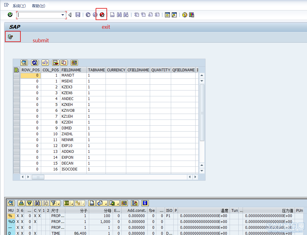

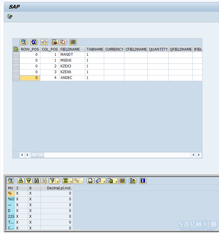

[ooalv] 编辑alv需要输出的fieldcatalog然后alv输出这些字段
Twilight发表于 2014-08-18 16:13Twilight 最后回复于 2014-08-18 16:13 [复制链接] 5220 0
需要创建screen 600、定义工具栏、逻辑流和container容器等,程序代码里有英文说明
  2. *& AS : ALV report which displays the contents of the table T006
  3. *& (as a docking container in the bottom) along with the
  4. *& editable ALV which contains the ALV fieldcatalogue table structure.
  5. *& With the available toolbar options of the editable ALV in the output,
  6. *& user can change the fieldcatalogue as per his requirement.
  7. *& When the user clicks 'SUBMIT',the display of the ALV with table T006
  8. *& gets modified and customised accordingly to the user's requirement.
  9. *&---------------------------------------------------------------------*

  57. *setting the screen for alv output for table display and
  58. *changed fieldcatalalogue display
  59.   SET SCREEN 600.
  60. *On this statement double click  it takes you to the screen painter SE51.
  61. * Enter the attributes
  62. *Create a Custom container and name it CCONT and OK code as OK_CODE.
  63. *Save check and Activate the screen painter.
  64. *Now a normal screen with number 600 is created which holds the ALV grid.
  65. * PBO of the actual screen , Here we can give a title and customized menus
  66. *Go to SE41 and create status 'STATUS600' and create THE function code 'SUBMIT'

  84. *&      Module  USER_COMMAND_0600  INPUT
  85. *&---------------------------------------------------------------------*
  86. MODULE user_command_0600 INPUT.
  87.   CASE ok_code.
  88.     WHEN 'SUBMIT'.
  89. *TO GET THE CURRENT FIELDCATALOGUE FROM THE FRONTEND
  90.       CALL METHOD cont_alvgd->set_frontend_fieldcatalog
  91.         EXPORTING
  92.           it_fieldcatalog = it_fielcat.
  93. *refresh the alv
  94.       CALL METHOD cont_alvgd->refresh_table_display.
  95. *to Send Buffered Automation Queue to Frontend
  96.       CALL METHOD cl_gui_cfw=>flush.
  97. *Exit button clicked to leave the program
  98.     WHEN 'EXIT'.
  99.       LEAVE PROGRAM.
  100.   ENDCASE.

  168. *to Send Buffered Automation Queue to Frontend
  169.   CALL METHOD cl_gui_cfw=>flush.
  170. * Display fieldcatalog of table T006 in editable alv grid
  171.   CALL METHOD cont_editalvgd->set_table_for_first_display
  172.     EXPORTING
  173.       is_layout            = it_layout
  174.       it_toolbar_excluding = it_excl_func
  175.     CHANGING
  176.       it_outtab            = it_fielcat[]
输出报表时我们不用考虑“MANDT”,现在我们编辑alv的一些字段(例如 直接删除一些字段),然后单击submit按钮,输出如下
