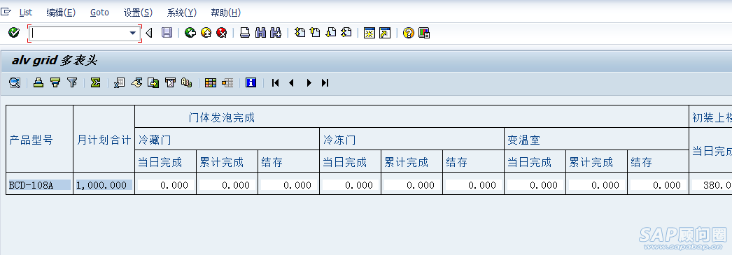

在表头中增加指定行数数据需要调用其"TOP_OF_PAGE"事件,"AFTER_LINE_OUTPUT"事件用于控制其报表输出后所处理事件

  63. INITIALIZATION.
  64.   l_variant-report = sy-repid.
  65. *******************************************START-OF-SELECTION
  66. START-OF-SELECTION.
  67.   PERFORM  eventtab_build CHANGING l_events.
  68.   PERFORM input_data.
  69.   PERFORM write_data.
  70. *&---------------------------------------------------------------------*
  71. *&      Form  write_data
  72. *&---------------------------------------------------------------------*
  73. *       text
  74. *----------------------------------------------------------------------*
  75. *  -->  p1        text
  76. *  <--  p2        text
  77. *----------------------------------------------------------------------*
  78. FORM write_data .
  79.   PERFORM get_fieldcat.
  80.   gs_layout-zebra = 'X' .
  81.   prg = sy-repid.
  82.   CALL FUNCTION 'REUSE_ALV_LIST_DISPLAY'
  83.     EXPORTING
  84.       i_callback_program = prg
  85.       is_layout          = gs_layout
  86.       is_variant         = l_variant
  87.       it_fieldcat        = fieldcat[]
  88.       it_events          = eventcat[]
  89.     TABLES
  90.       t_outtab           = itb_output[]
  91.     EXCEPTIONS

执行效果
